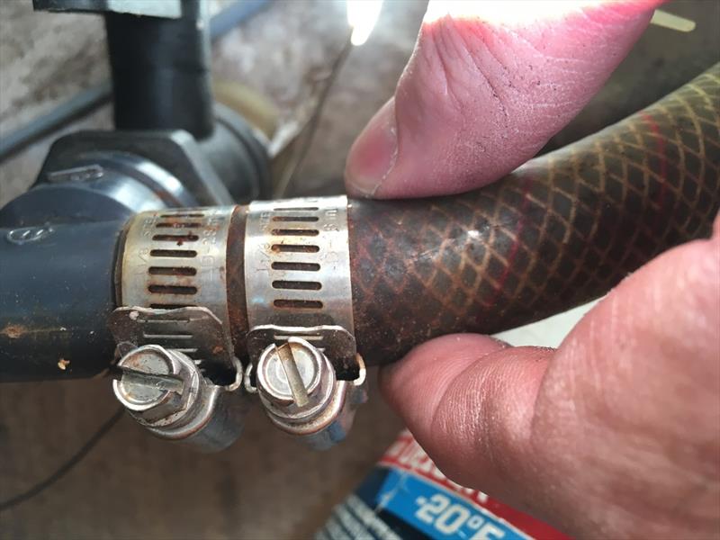

Inspecting hoses should be a part of your boat's Spring Commissioning. Any found too old and stiff, like this decades-old reinforced potable water line, should be on your list to replace © Scott Croft

1. Inspect and replace hose clamps as necessary. Double clamp fuel lines and exhaust hoses with marine-rated stainless steel hose clamps. While not technically required, it's a wise move to double clamp whenever possible on all hoses - especially those below the waterline.
2. Inspect all hoses for stiffness, rot, leaks and cracking, and replace any that are faulty. Make sure they fit snugly.
