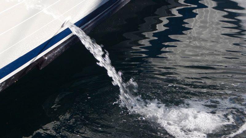

A bilge pump running © Boat Accessories Australia
