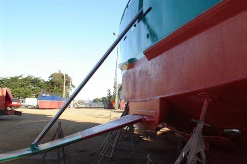

This safety alert aims to raise awareness of the risks associated with the use of fixed-fin stabilisers on fishing vessels. It is important to note that incorrect use of fixed stabilisers can lead to an accident and even cause a vessel to capsize.
Benefits of fixed-fin stabilisers
Fixed-fin stabilisers are also sometimes referred to as batwing stabilisers, anti-roll fins, fixed-arm stabilisers, passive-fin stabilisers and fixed fins.
They are designed to dampen, or reduce, the roll of a vessel, giving it a more comfortable ride in rough weather and possibly even making the vessel run truer.
Once installed, fixed-fin stabilisers are designed to be lifted up at certain times, such as when operating in shallow waters, crossing a bar and berthing. Failure to do so carries serious risk.
While fixed-fin stabilisers improve comfort by reducing erratic movement and minimising the roll of a vessel in rough seas, it is of paramount importance to note that they do not improve the stability of a vessel.
