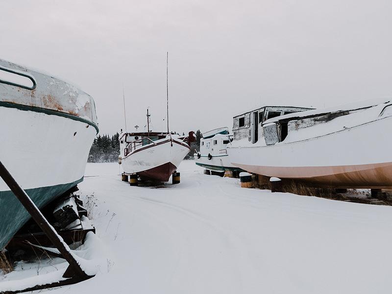

Prepare your boat for winter storage © Nathan Holmes
Thankfully, our Australian winters are not as extreme as our fellow boaters' overseas who often face sub zero temperatures. Nevertheless, there are steps that need to be taken to ensure you'll be ready to hit the water again once spring arrives.
