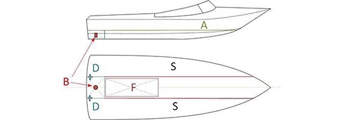

Diagram showing a profile and underdeck example - A: Sealed deck, B: Bilge pump, D: Drain, F: Fuel tank, S: Sealed compartments © Maritime Safety Victoria

A vessel with a sealed deck typically has the following features:
  • A number of watertight compartments in the vessel hull under the sealed deck, sometimes filled with buoyancy material such as buoyancy foam.
  • Access to these compartments for inspection purposes which are fitted flush to the deck. These are often 'spinouts' and must be watertight preventing water from entering the compartments.
  • Sealed deck penetrations carrying cables, fuel systems hoses, wiring etc or deck penetrations with openings high up under the gunwales.
  • A sump (usually aft) where deck water can collect and be removed using a pump.
  • A pump or pumps used to remove water from the sump. Can be a marine hand pump but is commonly a 12-volt electric pump.
  • A means to activate the bilge pump, usually a float switch is fitted in the sump which is lifted when water is present which turns on the pump.
  • The float switch may be connected to an audible bilge level alarm located at the helm, so the owner is aware of water in the sump and that the pump is operating.
  • Vessels with sealed decks are usually a step up in size from a 'tinny' and often have a fixed underdeck fuel tank which has a watertight deck panel fitted above it.
  • Decks are sometimes higher than the external sea level. To assist in draining the deck, drainage holes or 'scuppers' are often fitted at deck level through the transom. These are often fitted with flaps which close to prevent water entering the vessel in rougher seas.
  • Drainage holes in the bottom of the vessel are sealed with bungs to drain any water which finds its way into the underdeck compartments. These are screwed in prior to the vessel being launched from its trailer and removed when the vessel is retrieved.
