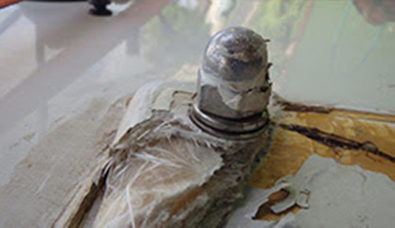

The boat owner said he'd bought the craft four years earlier and had noticed some cracks in the transom, but they did not appear serious.
This incident highlights the importance or regular inspections of hull and fittings on board vessels. In this case the bolts securing the pod to the transom were fastened with washers that may have been undersized.
Over time, the washers had crushed the flange on the fibreglass engine pod and this led to a catastrophic failure while under way. Regular checks may prevent failures like this occurring by identifying wear and tear early.

  • Look for signs of fibreglass laminate crushing
  • Look for signs of water ingress around bolts
  • Routinely remove a bolt to check state of fibreglass for water intrusion and to check compression.
When fitting an engine pod:
  • Good practice is to have a non-crushable core in the GRP laminate to drill attachment holes through. Core materials used should be crush resistant and compatible with marine construction standards and practice
  • Use large washers to spread the crushing load, not ones similar in diameter to the bolt heads.
